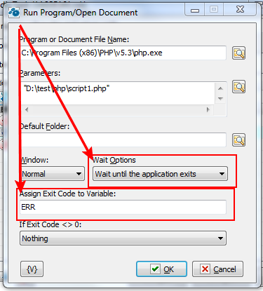

Like this:
Bez tytułu.png (12.93 KiB) Viewed 37989 times

There are two ways to achieve this.
1-st way.
Put into PHP script such code
die(<exit_code>);
-or-
exit(<exit_code>);
I use for my test simple script:
<?php
die(10);
i.e. my script generates the exit code 10.
You can catch and analyze this code in RoboTask (see screenshot)
See full task below:
