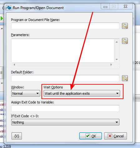

If you use command-line tool you can simply use "Wait until the application exits" option
See below:
In this case the task will wait until running tool will be finished.
If you want to use some GUI application (with key presses and mouse clicking) you should put necessary pause into the task.
Usage GUI application is not recommended, because this is not enough reliable way. Also system will ignore all keyboard and mouse simulation within locked session.
