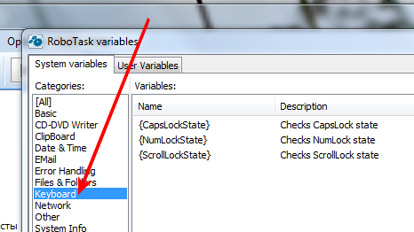

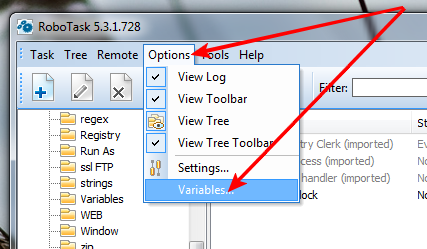

To identify the status of Lock keys there are system variables in RoboTask:
  • {CapsLockState}
  • {NumLockState}
  • {ScrollLockState}
These variables return a logical value “True” or “False” which corresponds to the status of a key. “True” means ON, “False” means OFF.
You can find these variables in the group of variables "Keyboard".
