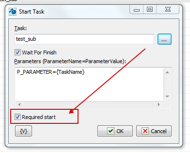

Re: Start task in parallèle
Try RoboTask version 6.4 please. We added new optoin into Start Task action: Required start
See screenshot below.
start task.png (24.89 KiB) Viewed 35699 times
Also we tested this on these examples. It works correctly:
