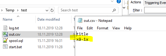

Starting start.bat via a single Robotask action ("run program/open document") without using any parameters gives me this result inside file out.csv:
title
xä-îx
This is bad. ;-)

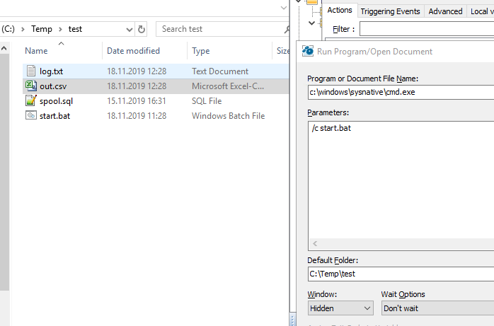

Re: Special characters
This behavior is strange...
Program: c:\windows\system32\cmd.exe
if you start from RoboTask you have to start CMD from sysnative folder (not from system32)
if you try to use system32, the system still starts CMD from syswow64.
SYNATIVE is virtual folder specially for 32-bit applications. (RoboTask is 32-bit application)
Try it please.

OK, I tried, but still wrong characters are appearing:
