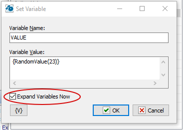

Posts: 3219
Re: Variable Time Difference
Pay attention to this option, please
If it is ON then the action calculates the value and save the result into variable
If it is OFF then the action saves specified string as-it-is. So you get the current date-time value in variable START_TASK, because RoboTask calculates the value every time when you use this variable.
Read more details here: https://robotask.com/forum/viewtopic.php?f=1&t=2359
Also see your corrected task below
