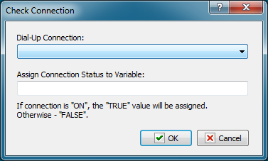

Checks the status of the selected dial-up connection and assigns the corresponding value to a user variable: TRUE if the connection is active and FALSE otherwise. This value can be later used in the "IF Then" action as a Boolean one.
Dial-Up connection
Select the connection you need from the list.
Assign Connection Status to Variable
Specify the name of the variable the status of the connection should be assigned to.
