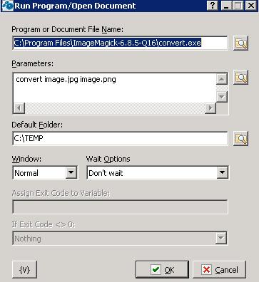

Re: Rezise
Posted: Thu Jun 13, 2013 10:01 am
by jeroen123
Dear Oleg,
Thanks! IT works!
For the ppl that struggle with settings, like me :oops: , pls find a pic how I did it:
Re: Rezise
Posted: Thu Jun 13, 2013 10:56 am
See my example and screenshot
You should specify full file names. It is better to use quotes (file name can contain space bars)
Also I recommend to use "Wait until application exits" option, because utility can work slow.
CatID=INTEGER|2099193306
ExternalName=STRING|"Task145"
ID=INTEGER|1372815363
Name=STRING|"Convert JPG to PNG"
Name=STRING|"Run ""convert.exe ""D:\Temp\P3150060.JPG""  ""D:\Temp\P3150060.PNG"""""
ifnonzero=STRING|"0"
params=STRING|"""D:\Temp\P3150060.JPG"" {EOL}""D:\Temp\P3150060.PNG"""
program=STRING|"D:\systemp\Downloads\ImageMagick\convert.exe"
runas=STRING|"0"
wait=STRING|"2"

Re: Rezise
Posted: Thu Jun 13, 2013 12:16 pm
by jeroen123
to add something to this forum:
pls use the following commandline (as parameter) to make a very small & light pic: 600px fixed in height, quality 90%, 72x72DPI, remove all information
$ convert "{TEMPLOC}\{namepic}" -resize x600 -quality 90 -resample 72x72 -strip "{TEMPLOC}\DETAIL\{namepic}"
