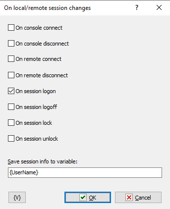

Hi,
i tried this funcionality, but the 'OK' button doesn't react.
Waht is wrong?
See screenshot
/Matthias
Re: Trigger logon
Enter only the variable name without braces
