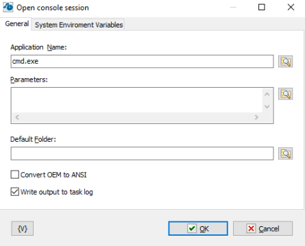

I've just recently this week on 5/29 started having an issue with this action for opening the console session so I could have cmd.exe open in order to write commands to the console to send files to a location we have online for a website. For some reason, it keeps giving the error below in the second picture. The first picture is the only settings I have on the Open Console Session. Also like I mentioned before, this only started happening recently starting yesterday and before now for the past year we haven't had this issue with the task so I'm wondering if something changed or if I need to add anything in order for this to work for the next action which is Write to Console Session to work! Thank you!

Re: Open Console Session Action Issue
Posted: Tue May 30, 2023 3:47 pm
Hm-m... It works without problem
look at my example below
CatID=INTEGER|1040932817
ExternalName=STRING|"Task1418"
ID=INTEGER|548263718
Name=STRING|"do DIR command"
ActionID=STRING|"A_CONSOLEAPP_OPEN"
Name=STRING|"Open console application cmd.exe"
application=STRING|"cmd.exe"
clearenv=STRING|"0"
covertansi=STRING|"1"
paramlinecnt=STRING|"0"
tolog=STRING|"1"
variablescnt=STRING|"0"
ActionID=STRING|"A_CONSOLEAPP_WAIT"
Name=STRING|"Wait for Text"
expr00000000=STRING|">$"
linecnt=STRING|"1"
ActionID=STRING|"A_CONSOLEAPP_WRITE"
Name=STRING|"Write To Console Session (dir c:\)"
command=STRING|"dir c:\"
linecnt=STRING|"1"
ActionID=STRING|"A_CONSOLEAPP_READ"
Name=STRING|"Read from Console Session"
clear=STRING|"0"
variable=STRING|"out"
ActionID=STRING|"A_DIALOG_SHOWTEXT"
Name=STRING|"Show Text"
autoclose=STRING|"0"
fromfile=STRING|"1"
line00000000=STRING|"{Out}"
timeout=STRING|"10"
I'm afraid that you have some system problem
Posted: Tue Sep 19, 2023 6:04 pm
by Zac
I was finally able to figure out the issue I was having. I did a temporary fix until now for fixing the issue by creating steps that would manually go through the step of opening cmd.exe and typing in the command I want and setting a timer to close the console session to move onto the next task. I figured out the reason why now that the task wasn't working and it wasn't a system problem. Turns out it was something super simple that I completely missed which was in the "Open console application" action in the "System Environment Variables", I needed to click "Copy from system environment" so that the "Open console session" could read the environment variables to open Command Prompt. I didn't think I needed to do that and that Robotask could just read it but it couldn't until I did that and it's working as it should now. Figured I'd post the solution here if anyone ends up making this simple mistake like I did.
