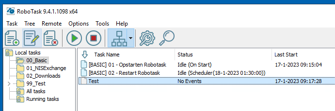

Hey Oleg,
I've noticed something funny. OS: Windows Server 2019.
After I connect to a previous disconnected RDP session to Robotask the "Run task" button doesn't respond. You can click 1000 times, no response. Control+Enter is working. When I restart Robotask, the "Run Task" is working again. Everything works then again.
Disconnect the RDP session and connect again at same resolution: same behaviour occurs. The icon doesn't respond until I restart Robotask again.

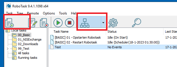

I've notived something else which maybe has to do with it, scaling is 100%:
Disconnect and connect again (same resolution):
Hovering on Run task button = Stop task
Hovering on Stop task button = Connect to remote Robotask
Can you reproduce it?
