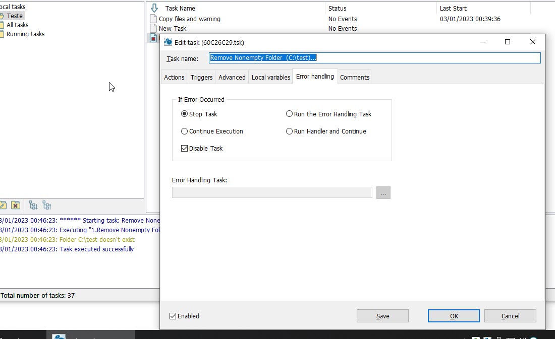

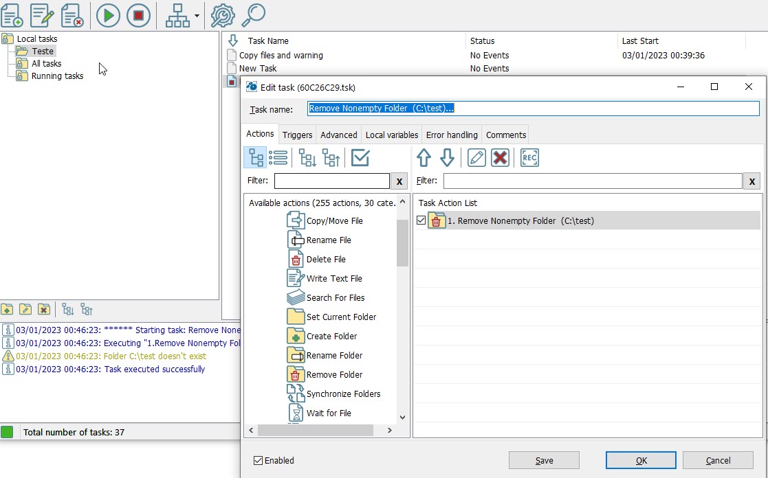

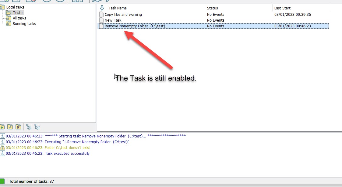

Hello...It worked perfectly, but taking advantage of the post, why don't tasks disable when the error occurs? in all tasks this happens .. what am I not doing right? How to disable the task if the error occurs?

Hello, thanks. I followed your example yes, but I still couldn't make it so that when an error was presented in the task, the task would be disabled. It would be a way to show that the task gave an error and did not continue

Version 9.4 has modified Exit action
You can generate your custom error.
Version 9.4 released yesterday (at 2023-01-03). Download and install it.
