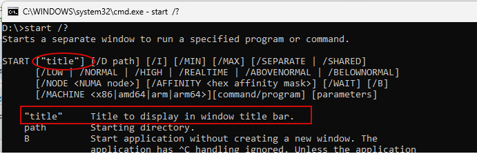

If you want to use command START you must use something like this:
start "Single task" "C:\Program Files\RoboTask\RoboTaskRuntime.exe" "C:\Users\daniel.kendall\OneDrive - Ideagen plc\Desktop\Notepad.tsk"
1-st parameter in quotes after START command is the title.
If you use the program name in quotes (and parameters too) the title parameter is required
