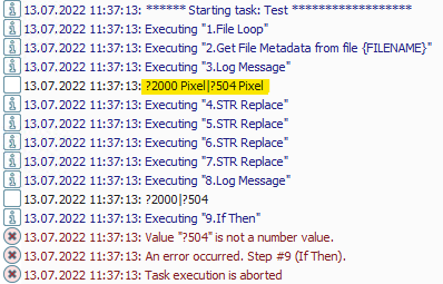

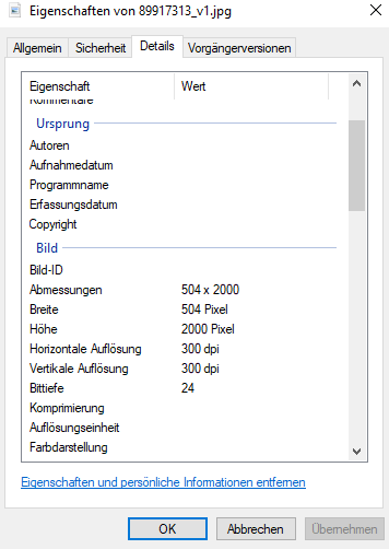

I want to get height and width from metadata of an image file with action 'Get file Metdata' to compare it and eventually rotate the image.
The data is always extracted with a preceding '?'.
I have tried unsuccessfully to delete the sign. I tried 'STR Trim' and 'STR Replace' but it is still available in the data.
Screenshot 2022-07-13 114225.png (37.92 KiB) Viewed 4888 times
Screenshot 2022-07-13 114312.png (17.1 KiB) Viewed 4888 times
I can't find the cause (I am using version 9.1.2.247). Could you please take a look at it?

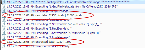

The problem is that the SYSTEM session has default language - English. Very often that English is the only locale in SYSTEM session
I writes small example (see below) and get the same result in service mode:
The log of the task
The log of the task
But you can extract numbers only by using regular expressions (see "Extracted data" line)
