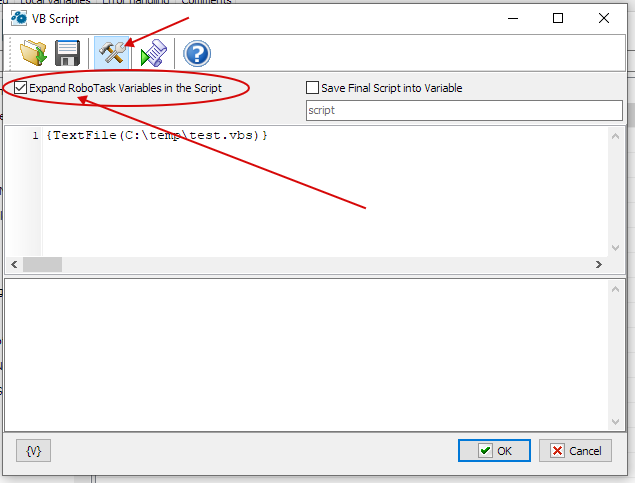

Yes but the pb is that I have a lot of "basic task" with the code in an external file.
So I hope to find a solution to replace by a VB script task, with code in external file.
And so I need to change my scripts once :-)
Re: "Old" Basic Script to new VB scripts in external file
Posted: Wed Apr 27, 2022 5:05 pm
Look at the screenshot how to include text from external file
Another way (more preferred):
use this text in VB Script text (for example)
execute include("C:\temp\test.vbs")
The extension is described here: https://robotask.com/help/index.html?sc ... esions.htm
These extensions works in actions:
