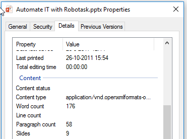

The total number of slides by the way is in the META file info of the file.
Yes of course, but it seems pckopat0699 wants to save the current slide number

The other remark is just for extra info. To learn, or to give extra idea's.
