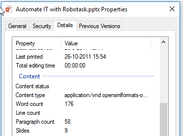

Just my 2 cents: what you CAN do is after every change of a slide by a keystroke (F5 or arrow right) increasing a counter variable. (Be ware of animations in your slide!)
The total number of slides by the way is in the META file info of the file.
Posts: 3219
Re: How Can I Get Powerpoint Current Slidenumber as Variable
Yes of course, but it seems pckopat0699 wants to save the current slide number
