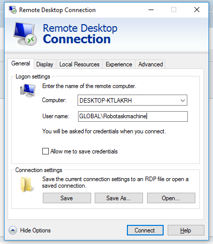

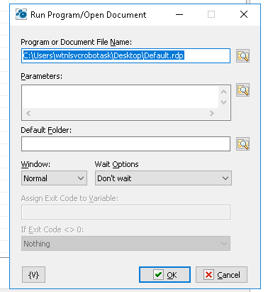

Start and run the command "mstsc", just in Windows. Make sure you configure every setting your like and press "Save as". Make sure you save the password when asked.
Now you can start the "RDP" file with Robotask by running a command.
When the task is executed, the RDP is started automatically. I've tested it without any problems.
