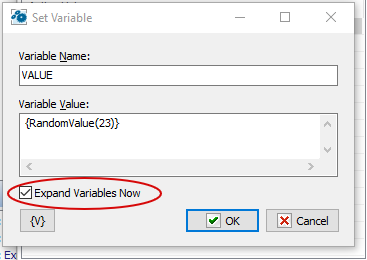

Hi, I've been trying to do something with no success.
I have at the start of a task a {NUMBER} variable set with {RandomValue(23)}, what that does is everytime I use {NUMBER} in next steps of the task the integer changes to a new random number.
Is there a way I can run only once {RandomValue(23)} and assign it to a variable that I'll be using several times later in the same task, with the same random number assigned at the start? :roll:
Thanks
Re: Fixed Random Variable
Posted: Thu Sep 27, 2018 9:29 am
Pay attention to this option (look at screenshot below)
If it is ON then the action calculates the value and save the result into variable
If it is OFF then the action saves specified string as-it-is. So you get different values in different steps, because RoboTask calculates the value every time when you use this variable.
Also look at my two examples. These examples demonstrates this option.
1-st example. You get new value every time
CatID=INTEGER|953684383
ExternalName=STRING|"Task185"
ID=INTEGER|-1830014808
Name=STRING|"random (NOT fixed)"
Name=STRING|"Set variable ""VALUE"" with value ""{RandomValue(23)}"""
varname=STRING|"VALUE"
varvalue=STRING|"{RandomValue(23)}"
Name=STRING|"Show ""{value}"""
msg0=STRING|"{value}"
2-nd example: you get the same value in different steps
ExternalName=STRING|"Task186"
ID=INTEGER|679974520
Name=STRING|"random (fixed)"
Posted: Thu Sep 27, 2018 3:15 pm
by george
Works perfect, thanks!
