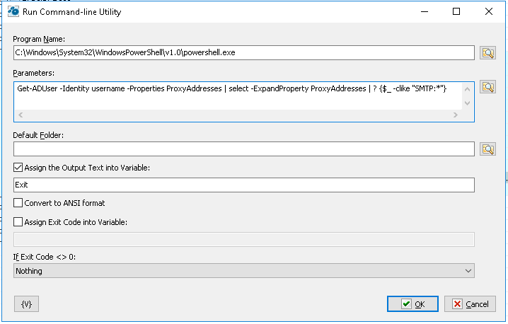

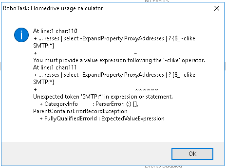

I'm using Powershell to determine a mail address which is attached to the username. The powershell script is working perfectly when I execute it directly from Powershell.
Get-ADUser -Identity [i]username[/i] -Properties ProxyAddresses | select -ExpandProperty ProxyAddresses | ? {$_ -clike "SMTP:*"}
As you can see, the last part of the command is using { and } . Robotask sees this part as a variable which is absolutely not the case. I've tried to include it between " and ' but no result.

Also I checked the helpfile to use the "internal" code for the {
Capture 3.PNG (3.64 KiB) Viewed 14220 times
But also this doesn't solve this. However, I really need this command, else output is too large. How can I do this the best?
Re: Usage of accolade (braces) in Powershell
Posted: Wed Aug 29, 2018 10:52 am
Run POWERSHELL through system command interpreter CMD.EXE
Command line is:
CMD.EXE /c <any_command_line>
Also look at my example below. It should work
Posted: Wed Aug 29, 2018 11:33 am
by Rukbunker
Almost there. It seems that the pipe sign | is messing up.
"Get-ADUser -Identity user -Properties ProxyAddresses | select -ExpandProperty ProxyAddresses | ? {$_ -clike "SMTP:*"}"
Posted: Wed Aug 29, 2018 12:24 pm
It seems you have to save your script into file with extension .PS1
and start it by command line
powershell -executionpolicy bypass -File <Filename>
Read more here, please
