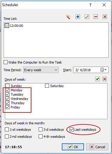

You can setup your task as my example below
CatID=INTEGER|1981091247
Events=FOLDER
ExternalName=STRING|"Task1"
ID=INTEGER|-617540483
Name=STRING|"Last business day every moth"
ActionID=STRING|"A_SCRIPT_VBEVALUATE"
Name=STRING|"VB Evaluate"
expression=STRING|"isLastBusinessDay(""{Date}"")"
line00000000=STRING|"function isLastBusinessDay(StrDate)"
line00000001=STRING|"  isLastBusinessDay = false"
line00000002=STRING|"  dt = cDate(strDate)"
line00000003=STRING|"  'month"
line00000004=STRING|"  m = DatePart(""m"", dt)"
line00000005=STRING|"  'weekday"
line00000006=STRING|"  wd = DatePart(""w"", dt, vbMonday)"
line00000007=STRING|"  'logmessage(cstr(m) + ""; "" + cstr(wd))"
line00000008=STRING|"  if wd >=6 then"
line00000009=STRING|"    'saturday or sunday"
line0000000A=STRING|"    exit function"
line0000000B=STRING|"  end if"
line0000000D=STRING|"  dt1 = DateAdd(""d"",3,dt)"
line0000000E=STRING|"  'month"
line0000000F=STRING|"  m1 = DatePart(""m"", dt1)"
line00000010=STRING|"  if m1 = m then"
line00000011=STRING|"    'not in last 3 days of the month"
line00000012=STRING|"    exit function"
line00000013=STRING|"  end if"
line00000015=STRING|"  dt1 = DateAdd(""d"",1,dt)"
line00000016=STRING|"  'month"
line00000017=STRING|"  m1 = DatePart(""m"", dt1)"
line00000018=STRING|"  'weekday"
line00000019=STRING|"  wd1 = DatePart(""w"", dt1, vbMonday)"
line0000001B=STRING|"  if m1 <> m then"
line0000001C=STRING|"    isLastBusinessDay = true"
line0000001D=STRING|"  else"
line0000001E=STRING|"    'next day sunday or saturday"
line0000001F=STRING|"    if wd1 >= 6 then"
line00000020=STRING|"      isLastBusinessDay = true"
line00000021=STRING|"    end if"
line00000022=STRING|"  end if"
line00000024=STRING|"end Function"
line00000026=STRING|"'logmessage(isLastBusinessDay(""3/30/2018""))"
linecount=STRING|"39"
loadfromfile=STRING|"1"
variable=STRING|"match"
connection=STRING|"0"
count=STRING|"1"
operator=STRING|"0"
type=STRING|"3"
value1=STRING|"{match}"
Name=STRING|"Show ""This is last business day"""
msg0=STRING|"This is last business day"
msg2=STRING|"Put your actions here."
msgcount=STRING|"3"
ActionID=STRING|"A_FLOW_ELSE"
Name=STRING|"Else"
Name=STRING|"//Nothing. This is NOT last business day"
comment=STRING|"Nothing. This is NOT last business day"
[Events]
Event1=FOLDER
[Events\Event1]
UniqueID=INTEGER|1587115508
[Events\Event1\Params]
periodicity=STRING|"1"
periodparameter=STRING|"0111110"
periodparameter2=STRING|"00001"
startdate=STRING|"43137"
time0=STRING|"43200000"
timecount=STRING|"1"
wakeup=STRING|"0"
The algorithm is simple:
Check the date: is this last business day or not
next use If..Then action
Also I set the scheduler trigger as on screenshot
Scheduler parameters
