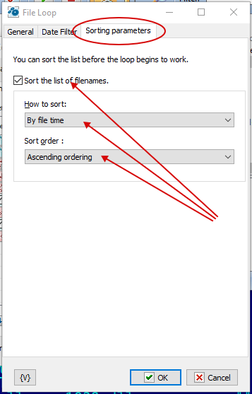

The main problem - you have to determine the oldest file in the folder
You can do this If you sort the list of files by filetime.
Look at the step #3 (File Loop)
After the loop the variable FileName will contain the name of oldest file in the folder.

These steps are the steps of algorithm of the task.
#1 Set the folder name where are your files to variable FOLDER
#2 set initial value to variable FileName
#3-#4 The loop which enumerates all specified files ({Folder}\*.zip)
#5 Checks the value in variable FileName after the loop
Steps #6 and #8 are information alerts only
You can place your own steps instead of step #8 to copy file somewhere or do some another actions with the file.
