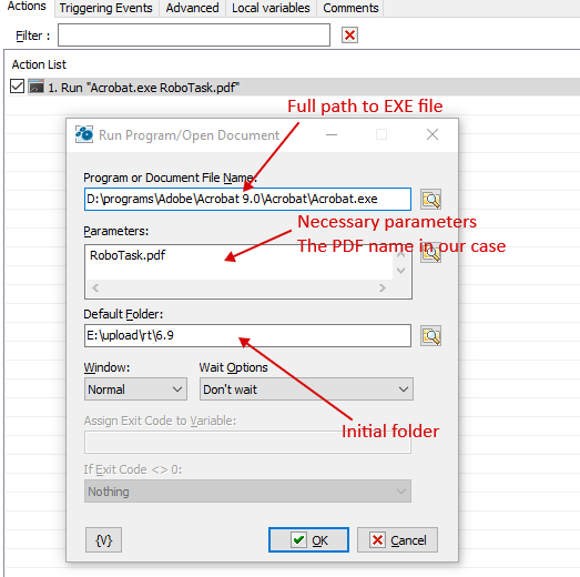

Look at the screenshot below:
run program.png (36.04 KiB) Viewed 32072 times
Also look at my examples below
Open PDF document in FoxIt reader:
CatID=INTEGER|444033236
ExternalName=STRING|"Task285"
ID=INTEGER|1482720006
Name=STRING|"Open PDF in FoxIt reader"
Name=STRING|"Run ""FoxitReader.exe RoboTask.pdf"""
ifnonzero=STRING|"0"
params=STRING|"RoboTask.pdf"
program=STRING|"D:\programs\FOXIT SOFTWARE\FOXIT READER\FoxitReader.exe"
runas=STRING|"0"
wait=STRING|"0"
workdir=STRING|"E:\upload\rt\6.9"
Open the same PDF file in Adobe Acrobat Pro
ExternalName=STRING|"Task286"
ID=INTEGER|1316890082
Name=STRING|"Open PDF in Adobe Acrobat"
Name=STRING|"Run ""Acrobat.exe RoboTask.pdf"""
program=STRING|"D:\programs\Adobe\Acrobat 9.0\Acrobat\Acrobat.exe"
runas=STRING|"0"
wait=STRING|"0"

Re: Open file with...
Posted: Tue Aug 22, 2017 7:15 am
PDF name contains the space: verbale_BONGIORNO_Francesco paolo_20170211_448.pdf
So you have to use quotes
The command line will be such:
<full_path_if_necessary>\fcsign.exe "verbale_BONGIORNO_Francesco paolo_20170211_448.pdf"
By the way you can use quotes with any file name. System should process it correctly.
