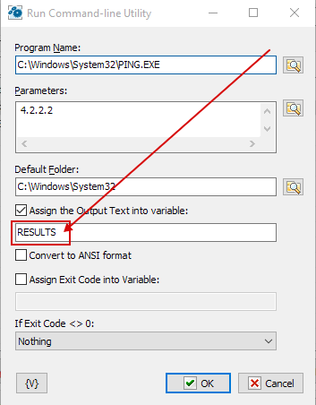

You should use varable name only in Run command-line utility action
See screenshot:
Also see corrected task below. Save the text of the task to a file and use menu Task->Import to import the task into RoboTask.

Ahh! Many thanks! Might I suggest that when you click the {v} button to select variables (to add them into that field) that is removes the brackets when you click ok? Or perhaps some sort of note in the documentation indicating not to include the brackets? I scoured through the documentation and never saw anything about that (I might have missed it still). Thanks!

In this case you have to input the name of your own variable.
Also you can compose the name with using another variable. For example: MyVar{num}
This can create enumerated variables: MyVar1, MyVar2, MyVar3, and so on
