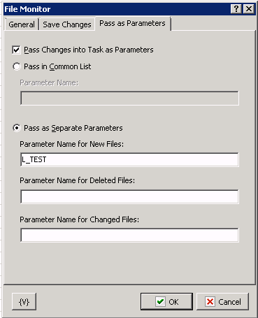

file monitor is working fine and the task starts immediately after a new file was copied into a folder.
My question:
How can I access the filename of the new file inside the task?
I tried this way but {L_TEST} is always empty inside the task:
Any suggestions?
Thank you.

In your example I see that you pass only the list of NEW files. Maybe the problem is here?
These parameters contains the list of files as text: one name per line

Thank you, Oleg.
No, this works fine.
The reason was:
I additionally declared these parameters as local variables, too.
No good idea... :oops:
Re: Get filename of file which triggered file monitor
You do not need to declare variables. It's enough to pass some parameters and you can use them as variables.
