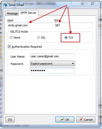

Use these parameters for STARTTLS (see screenshot below)
It works on Gmail servers.

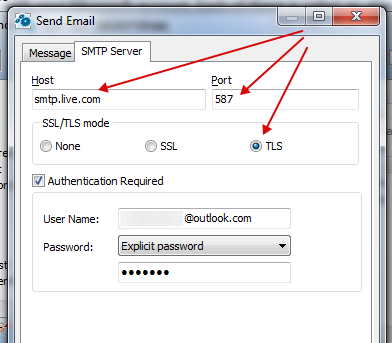

But it couldn't send email from outlook to hotmail.com
I am sure about config...I don't know what's wrong if there is no difference between starttls and tls.
Re: STARTLS port for sending emails
Posted: Thu Feb 26, 2015 3:54 pm
I tested Outlook SMTP with same parameters. I wrote the task and tested it. It works.
Probably you should tune settings in your account.
See here description of hotmail setting
