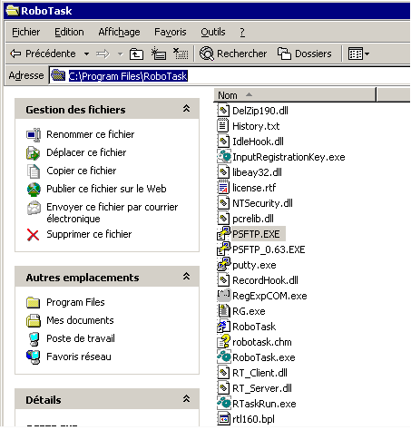

Note 1: The psftp.exe is existing in Robotask installation folder. The version that came with Robotask was 0.62. I even downloaded the latest version (0.63) from putty site, but I am still having the same error.
Note 2: I can successfully telnet the SFTP server. I can also successfully connect to the SFTP using the psftp.exe from Command Prompt.

This error is being appeared only if RoboTask can't launch PSFTP.EXE utility.
1. Check the existence PSFTP.EXE utility in RoboTask's folder
2. Try to run PSFTP.EXE utility manually from RoboTask's folder. Probably you will see the problem. Maybe the execution PSFTP is being aborted with some error. Maybe you should move your certificate into RoboTask's folder or specify full path to certificate in your profile.

The PSFTP.exe is existing in RoboTask's folder.
I also tried using the PSFTP.exe manually in command prompt. I am connecting successfully, using the profile I specified in the task.
I even added the Robotask's folder to the PATH variable, so that I have the "psftp" command know from command prompt.
But still I have the problem.
Can the fact that Robotask is installed in "Program Files"(folder name with space) be a possible reason that Robotask cannot find the PSFTP.exe?
