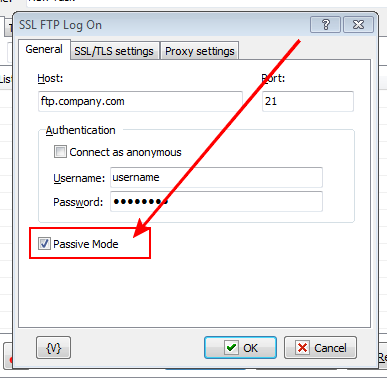

I think you mean SSL FTP actions. Correct?
Try to use passive mode at logon (see screenshot below)

I've already tried that one. It fails in passive or active mode.
