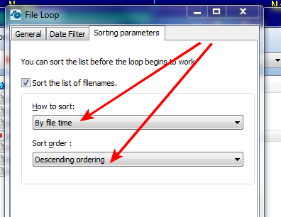

You can use file loop with sorting.
Use the sorting by file time with descending ordering (see screenshot below):
The 1-st file in the loop is a newest file.
The full example:

Also I recommend you to use such algorithm:
Suppose you have two folders: incoming and sent
You should monitor only "incoming" folder.
When the folder changed you send all files via email from incoming folder as attachment and move all files into "sent" folder.
Thus, "sent" folder contains only already sent files and incoming folder is empty by default and it can contain only new files.
