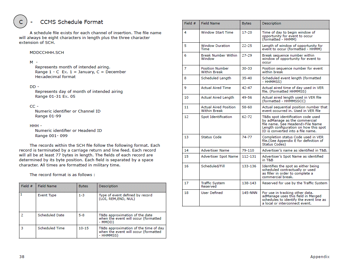

Ok so the last sample I gave you had both 15's and 10's in it. The first sample file I sent was just an example of the files layout. I cant give you an entire file because currently we don't generate one with both 10's and 15's. That is why I provided you with my last example.
So as you can see in my last example, I have manually created a before and after. In the before, I am showing you what output would be like in the original file in just a 1 commercial break segment. How to identify when we need to make the swap is whenever you see a line that has a 15 followed by a 10 OR a 10 followed by a 15, the lines need to be flipflopped as shown in the "After" section.
For further clarification of the data fields, I have included a CCMS file format guide in attachements. I also included a full schedule file (without 15's) in the zip file attachment.
- Attachments
- CCMS Format Guide
- CCMS Format.GIF (80.26 KiB) Viewed 31984 times
52368020.zip- Example Schedule File
- (14.78 KiB) Downloaded 3133 times
