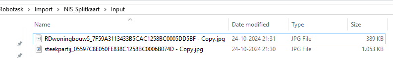

The 2 files:

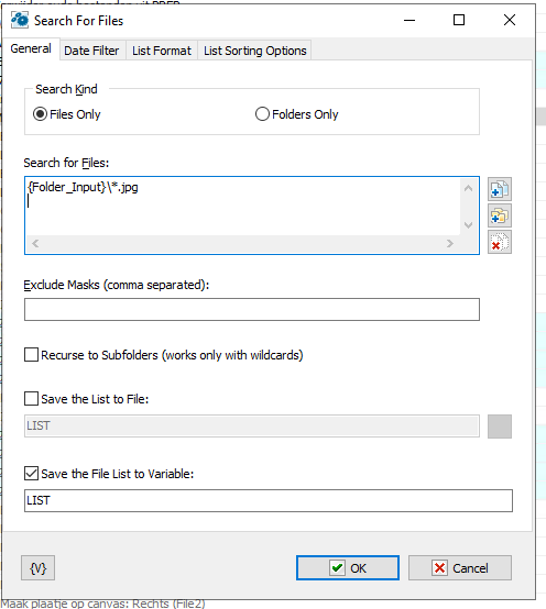

Creation of the list:

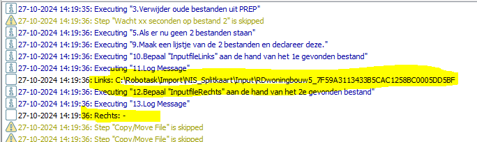

The Log Message shows me this: (I'm using: Links: {LIST(0)})
It looks likes it goes wrong at the first space. The second file (called with {LIST(1)}) is only displaying a "-".

Search for files action creates a multiline text (not comma separated string)
So the variable LIST contains the text with two lines (in your case)
You need to use Text loop to process your files sequentially
If you want to retrieve file name by line number use TXT Extract Line action
Also if you want to use comma-separated string use TXT Comma-Text Conversion action
By the way: by default, the space character is a data separator, like a comma in a standard comma-separated string.
