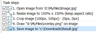

Lana_K
Posts: 55
Joined: Tue Jul 14, 2020 7:43 pm
Location: Bristol, UK
Re: image manipulation
Post by Lana_K »
To me it looks like Robotask can easily perform all the actions in exactly the order you described. I maybe am missing some specifics you require but this worked on my laptop
I saved it only once at the end
Posts: 238
This works, that's true. But I can imagine that the amount of compression in the pictures which Robotask modifies can be "not wanted".
