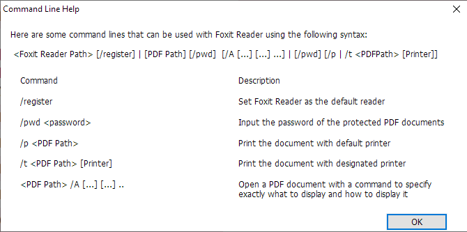

You can run Fixit Reader with command line to print PDF file
Look at Foxit Commands
But you have to enumerate all PDF files in the loop (see File Loop)
