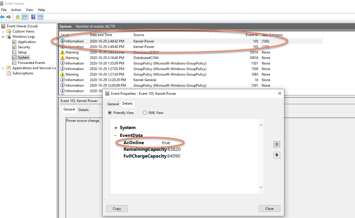

Hi there.
I would like my triggering event to be when my laptop which is on (not off/asleep/hibernated) detects that AC power is restored. This is logged as an EventViewer/System/Event 105. I have attatched a screencap here of the event. Can i create a custom trigger? or does one already exist? Is there another way?
(Didn't mean to do a double post. Last one was made without a proper title.)

Thank you for your response.
The problem with this approach is that some power fluctuations that we are trying to detect only last for a second, therefore checking every 10 seconds will likely miss it. That momentary power bump is an actionable for us as there is other equipment that require remediation after such events.
