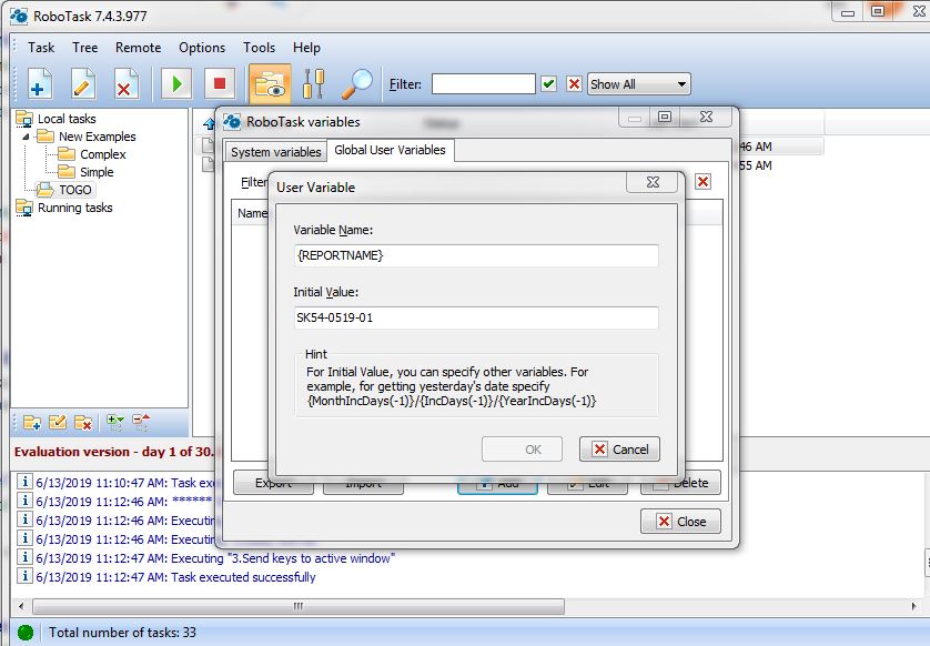

Hi I just try to use Robotask for few days.
I want to define some custom variables, but after I put in the name and initial value,
the OK button still under locked, what happen to this? Because I am using trial version?
(See attached photo)

Posts: 3219
Re: Failure to create custom variable?
You must enter variable name only (without braces)
Try the string REPORTNAME

Oleg wrote:You must enter variable name only (without braces)
thanks, problem solved
