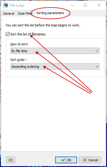

The main problem - you have to determine the oldest file in the folder
You can do this If you sort the list of files by filetime.
Look at the step #3 (File Loop)
After the loop the variable FileName will contain the name of oldest file in the folder.
